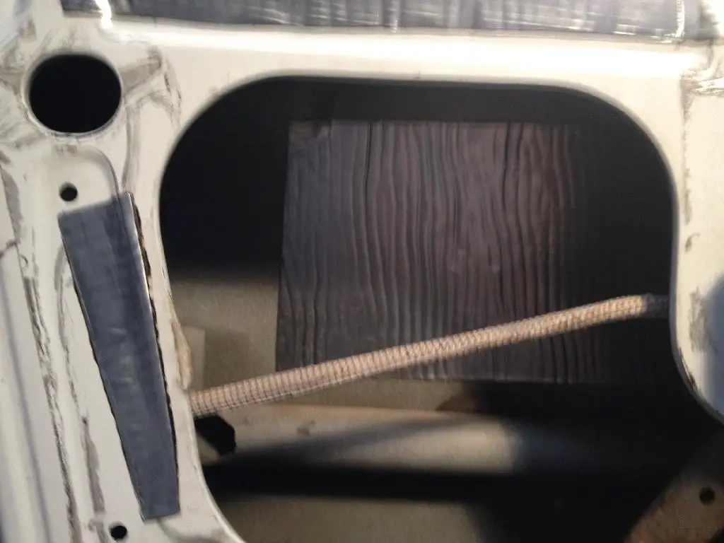

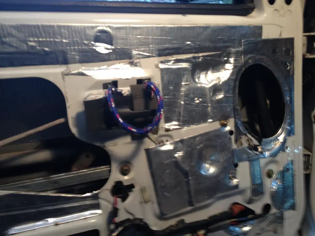

Update on how the insulation is holding up and a note.
First the insulation has been holding up great and it will not come off easily so make sure you won't need to remove it.
And here's the note. Make sure you drill the hole for the window motor removal so you won't have a PITA time later when the bushings in the motor decide to go.
There's a thread on where and how to locate the spot with the bolt under it so I'm not going to post that info.
Here's a pic of what I had to remove to get to the spot though.
It took a good 30-45min of scraping and pulling with pliers to locate the spot to drill. So I think it's safe to say that with proper installation this stuff isn't going anywhere.
