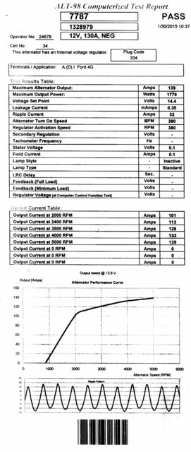

Anyway, here's the test report from my alternator. I thought it was interesting to see the difference in current at different RPM, though I don't know what ratio its RPM is to engine RPM... surely it's spinning over 5000RPM at the engine redline.
