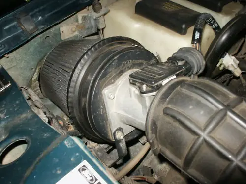

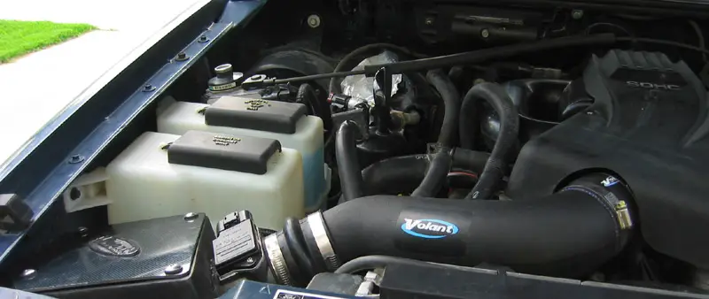

Here's the Volant setup I had for my SOHC:
And slightly modified to fit my 5.0
In both cases the filter just hose clamps onto the C&L MAF body and the Volant box supports it. The standard Volant setup without C&L hooks up slightly different with a small adapter. OEM MAF clamps on one side, filter on the other.
