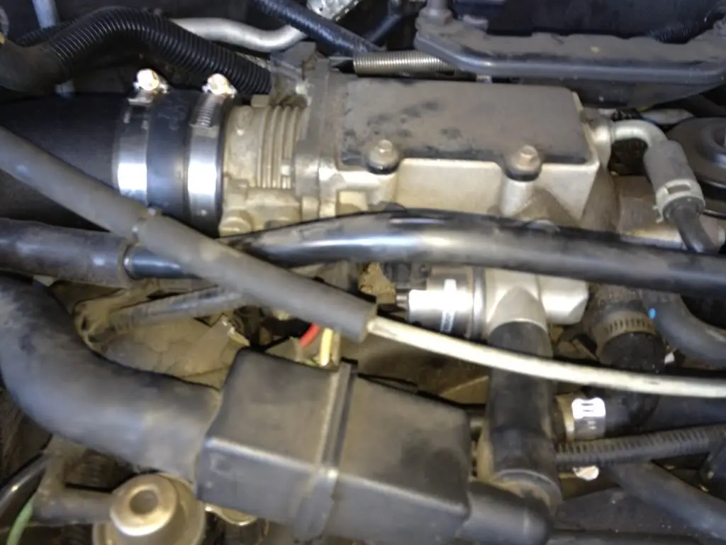

I just finished cleaning my IAC valve extremely thoroughly.
I've got to drive about 50 miles tonight so we'll see how it runs.

For stalling issues on 02-03's clean the throttle body and MAF to see what happens. Cleaning the IAC on these may not help, It may just need to be replaced. The coil that opens and closes the IAC is not servicable and can sometimes go bad. For 04 and up remove and clean the throttle body, perform the idle relearn procedure ( i think it is in the owners manual).
