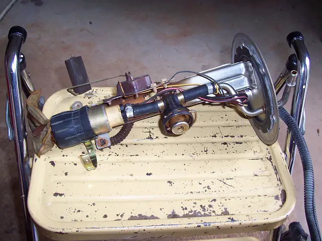

In 1999 the Explorer went from a lower pressure return fuel system to a higher pressure returnless fuel system. The specified pressure for your vehicle is 65 +/- 8 psi: Ford Explorer Ranger Fuel pressure test procedure
There is a hose between the fuel pump and the FPR that can split.
There is also a hose between the FPR and the top of the assembly that can split.
There is a check valve in the assembly that prevents the loss of pressure when the pump isn't running. If the hose isn't split the check valve could be stuck open. Since your pressure is low and drops immediately to zero when the pump isn't running I suspect a split hose: Fuel pump replacement - 2000 Explorer Sport

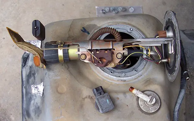

Split in hose on fuel pump
Good call 2000StreetRod! Finally got the tank down and the pump out, the split in the hose was obvious. I'll figure out how to post pics and show the split. Now I get to wait another week to put it back together and see if it will start with a new pump. Thanks!
