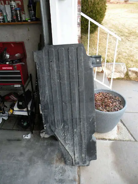

Skid plates
When I bought this truck, I assumed it had skid plates. My old Ranger did, but I didn't know they were an option for the Explorers. Previous owner opted NOT, and the truck now reminds me of a soccer mom car!
Some had a gas tank skid plate (it was optional).
No skid plates to protect Cats?
I also smashed the hell out of my A/C condenser, yet the A/C stills blows ice cold. Got lucky there (Thats what proper skid plates should protect).
