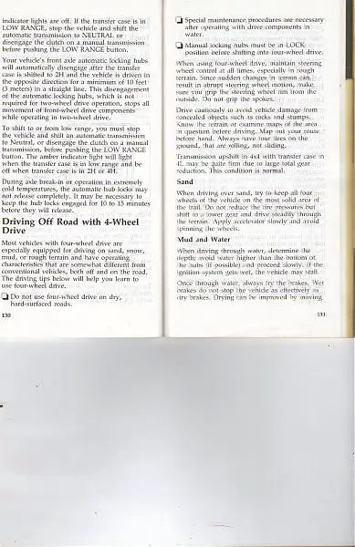

Only thing that I'm pondering is - why do I have to reverse to disengage? I read a few other threads of people mentioning this, including this thread, but no explanation why.
Also, how do you know if a cam is bad? Why do some of the metal pieces with the 3 triangles spin freely in the cam, and others get caught up and take slight force to move them? Is that the sign that they're bad?
Thats the way ford designed them, If you read the 4x4 section in your owners manual it tells you to back up to disengage the hubs.
I bought this Explorer in 2004, I was probably the 4th owner, I then passed it on to by dad, the original manual disappeared along time ago. Do you have a reference to these pages I can see?
Locking hubs are a way to save some fuel economy (1-2mpg) when they are unlocked. When the hubs are locked (and 4x4 is off) the wheels are rotating the front axles shafts and differential which is a slight drag on the system. When unlocked the wheels are disconnected from the axle shafts thus saving some mpg because of the reduced drag..
Here ya go
Its kinda hard to see but its the second paragraph on the first page.

Thanks! One thing though - assuming you turn 4x4 off by pressing the button and the hubs don't disengage until you reverse, should it be making the winding noise without them disengaged(as mentioned in my steps above)?
Yea because the cam or hub is worn out and its trying to engage buts its not so it just keeps making that racheting noise
