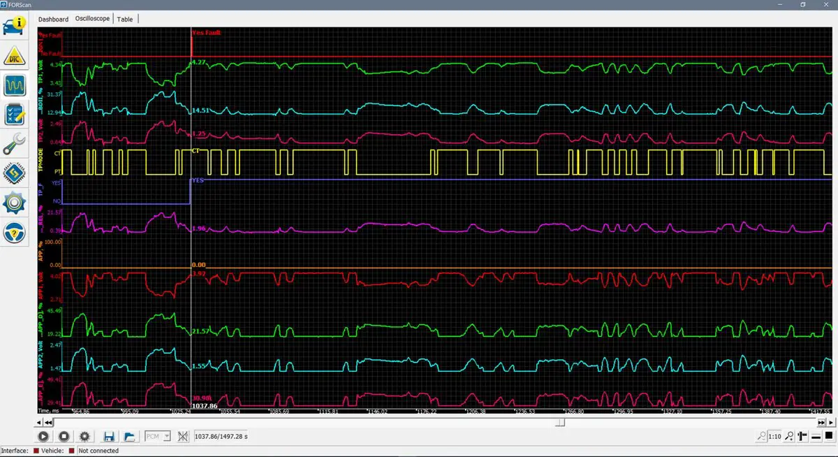

Hey guys,
The wife was driving the Explorer around today and contacted me about the orange wrench popping up. She said it was accelerating weird like it has on a few occasions in the past. We drove the Explorer a bunch in the last few days with no issues (besides my normal rpm surge issue). I go out and get the FORScan hooked up and check it out.
Right off the bat I see the PCM module is saying "P2135-FF" and under OBDII module it's saying "P2135-P." I go to the PID Data and throw on a few values like the TPS sensors (1 & 2) and Accelerator Pedal Position sensors(1, 2 & 3), along with some other relative values and test drove it.
It would accelerate through 1st gear fine, acceleration completely cut out for a second or two when it would shift to second, then it kicked back on and continued as if nothing happened. Very strange stuff. I've looked over the live data and can't really seem to pin point anything. I saved out the live data and uploaded it to my DropBox if anyone cares to take a look - Dropbox - FORScan
I tried to watch the live data as the problem was occurring and nothing but the TPMode (Throttle Position) was really changing (CT vs PT) but I think this is normal data behavior but could be wrong (should is taper off instead of abruptly going up CT and PT?
:dunno:
I had some more time to look at the data and found this snippet -
I'm a complete amateur at this, so my extreme apologies... Should TPS sensor A & B should have mirroring voltages? I'm seeing a bunch of discrepancies between the 2 voltages. Anyone know if I'm reading this right?
Everything says to replace the TPS sensor but I don't think this is the case. I'm hoping to get some time this weekend to start cracking into the wiring harness to the TPS sensor and see if there's any exposed wiring.
Got to cut back a bunch of the tape/plastic crap protecting the TPS sensor wires and the throttle body wires. Got about 8 or so inches back before calling it quits. Even started going back on the MAF wire for S&G. Wires were surprisingly better than I had expected them to be. Nice and pliable and looked pretty pristine with no visible cracks/exposures. The MAF wires looked a little more beat up than the others, but again, nothing visibly wrong. As much as I hate throwing parts at stuff, with my limited expertise that's about all I can really do at this point. Ordered a new TPS sensor and will hopefully get it on by next week. Will reset the PCM after installation.
Before I inspected the wires, the CEL finally turned off last night. Drove it this morning and it drove perfectly fine. Seems like some days it drives better than others but I haven't noticed any correlation with the weather. Not sure if it's the throttle body, I'm doubting it though since I replaced it about 1 year ago. Fingers crossed that its the TPS sensor... :chug:
