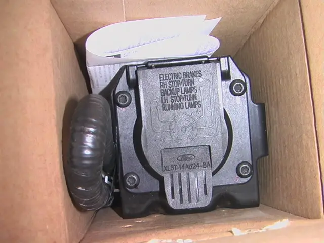

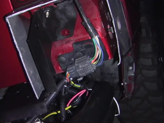

Here are the pics I have. I ordered the 7-point harness to replace the 4-point harness. Here is the harness, here is a cut out of where and how they attach, but some of the connectors just don't have power - period. I'm working on that myself...
