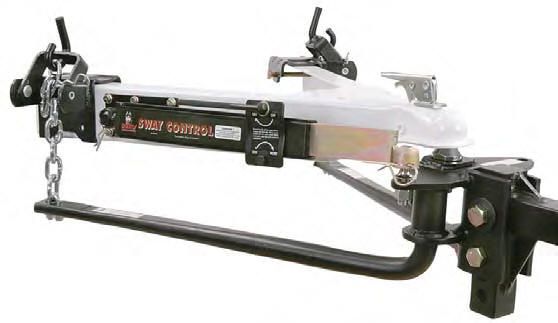

The anti sway bar you posted is one that mounts onto the vehicle's axle and frame. For towing, you are going to want to look at trailer sway control systems, i.e.
A thicker sway bar on the explorer helps as well.

Vehicle antisway bars won't do much to prevent trailer sway, but yes, I agree that once the trailer starts to sway, the thicker sway bar on the tow vehicle will help in responding to sway. I just didn't want OP thinking that vehicle sway bar was the only way to go...
Thanks wifes2011xlt. The hitch setup I have is a weight distributing hitch with sway control. What I'm looking to do now is modify the truck suspension for all around better stability and control. Towing today is a little sloppy, and it feels like the trailer is doing most of the driving and pushing/pulling. Sway bars on the Explorer is just going to be the start. Future improvements, like quick struts, springs, or airbags, I'm still learning about and looking into.

You're on the right rack getting the weight distributing sway-damped hitch. I'd say replace the worn out rear shocks before you drop for the sway bar set, and you might find that it is adequate enough that you don't need to buy sway bars and can afford to buy front shocks as well.
