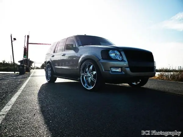

A Good Friend/Fabricator Of Mine Cute My Struts And Rewelded them And Aligned My Rims For Me; [24" Devino Rims]
