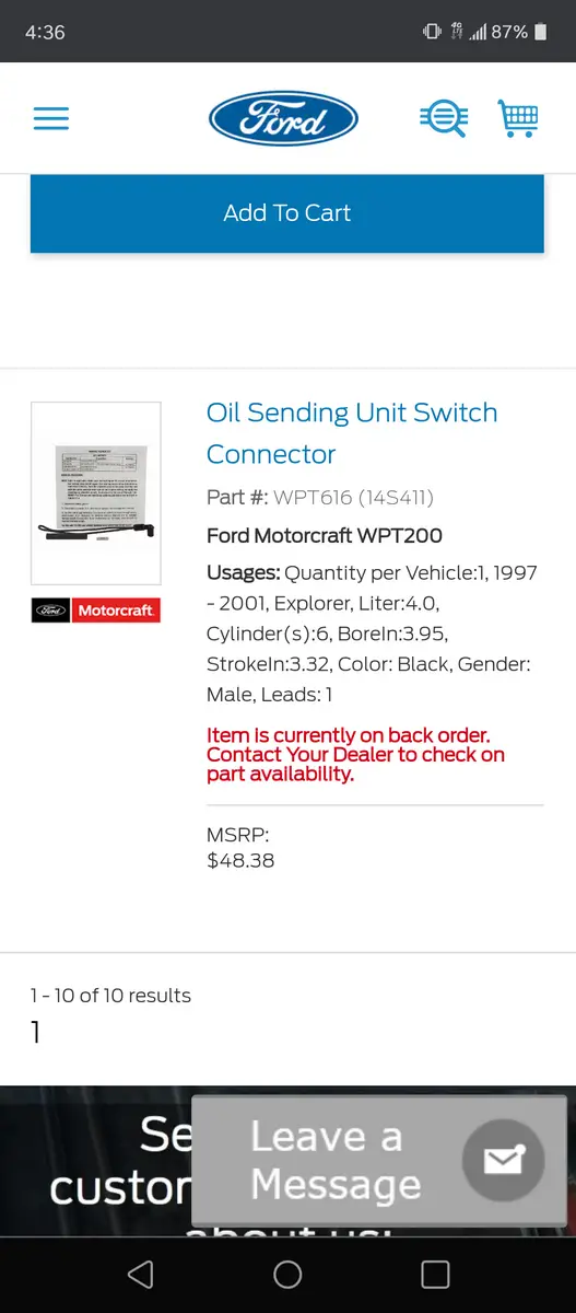

This was provided as response to you in another post:
Does this look like the part you are trying to replace?
Obsolite or PN invalid. Next step "your local junk yard".
That oil pan sensor is hard to find sometimes, I've read they were obsolete ages ago. There should be some kind of replacement, it is not a complicate part. Those tend to leak, but almost never fail. First see what yours looks like, is it covered in oil, and is the connector on it and looking good?
I'll check it out. I need to put some brake pads on anyway. While it's on jacks, I'll have a chance to take a good look at the sensor (sender).
