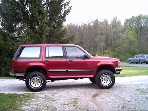

Not the gratest pic but it could give you an idea, mine are the MY Classic with Ford center caps.
15x8's running 32-11.50's
