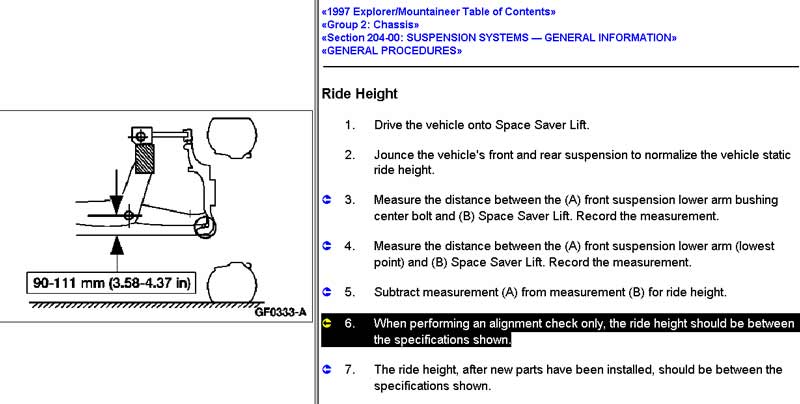

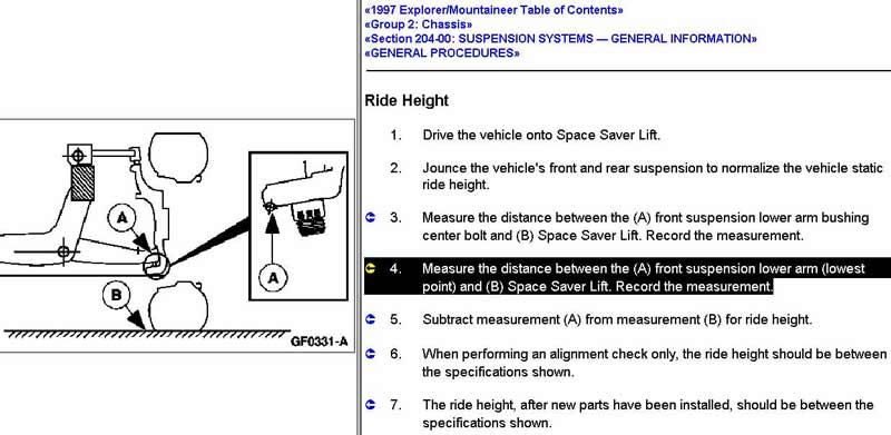

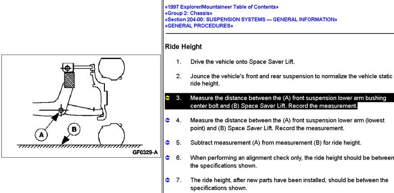

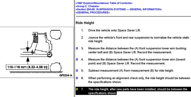

i was curious so i could compare
This is the Ford Manual for 97. Should be the same as 96.

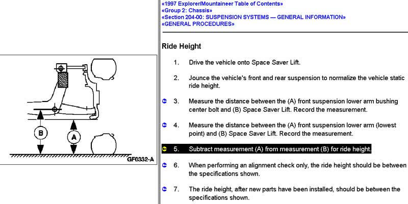

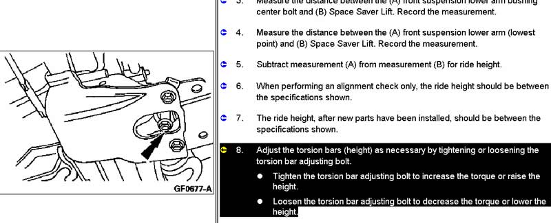

more info
