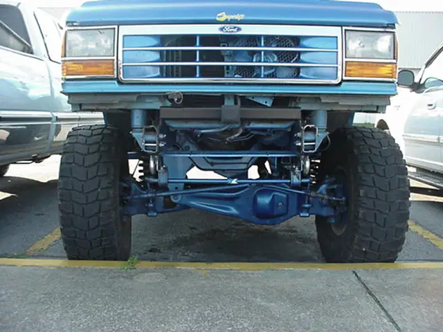

its not that hard,mine is blue
mike, did you paint under your explorer or have someone else do it. i think that looks cool.
or you could go to a junkyard and find a "limited" grill and paint it. they don't have any chrome on them and personally, i think they look better. but there's always the unchromed sport grille that Crankcase mentioned. good luck
looks good madmike, but i'll be painting the entire grille chrome and all. Even the lil pieces around the headlights.
I painted everything, just have to make sure you degrease really good then hit the wire wheel and a drill for ever then prime and finally paint, I dont really like all the blue so I'm painting the drop down brackets and sway bars, and steering stuff black. thanks guys.:D
