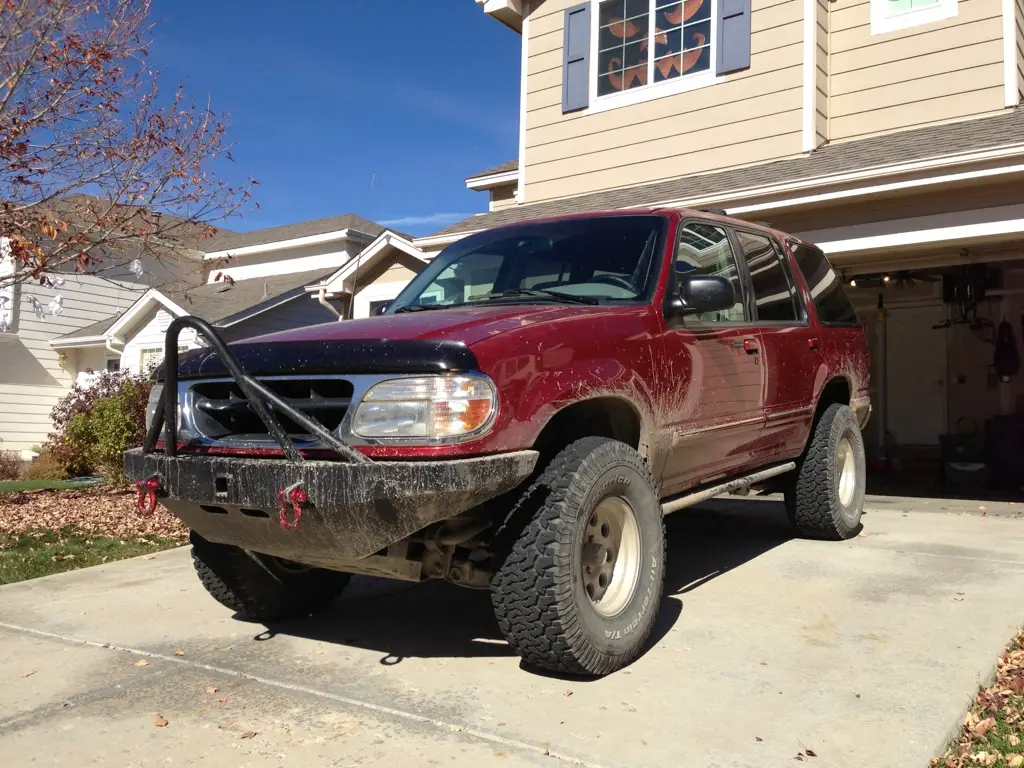

While not a Sport Trac:
But yes, I've had the same thoughts about a winch. I don't have one yet, but I plan to get some kind of tray winch and possibly loading it with synthetic line to keep the weight down. Makes a bunch of sense to have the versatility to be able to pull yourself out either forward or backward depending on the situation.

Tom do you have a BL?

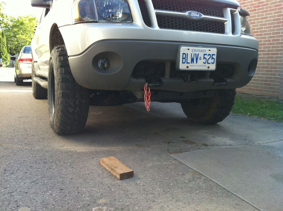

You just reach into the opening of the bumper cover and turn the handle.
I like the idea of having the winch hidden for theft protection, the weather and it reminds me of the old and new Dodge Power Wagons with the hidden winch.

No. But the front bumper was custom built, including the hitch, to match the lift.

i have a front receiver hitch on my trac. bought it at the local autoparts store for less then 200bones it adds a nice touch to the vehicle and i have used it many times. i really enjoy it, and knowing how flimsy the front frame horns are on these trucks, it bolts them both together and acts like a brace to strengthen it well.
heres a close pic of my receiver (pre-lift) :P
