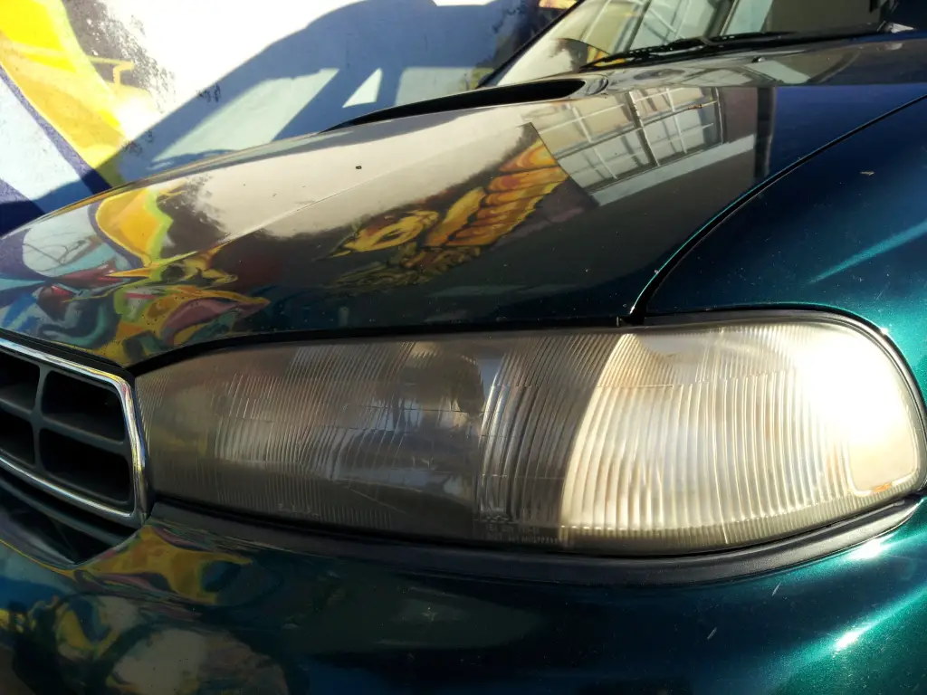

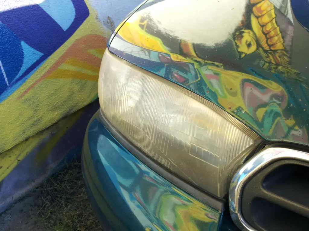

wow, nice discussion and good advice across the board. here's a few pics of the headlights im trying to restore.

Good before pics. Standing by for the after pics..........................:popcorn:

Those don't look too bad, I'd probably use polish on those. Sanding seems overkill.
Don't use clear spray paint on headlights. The newer kits come with protectant, either stuff like the Meguiar's that you use like wax every so often, or UV protectant like in the Sylvania kit. I think the new 3M kit comes with some sort of protectant as well.
Either way, buy one kit and follow the directions. Results should be good if you take your time and do it right.

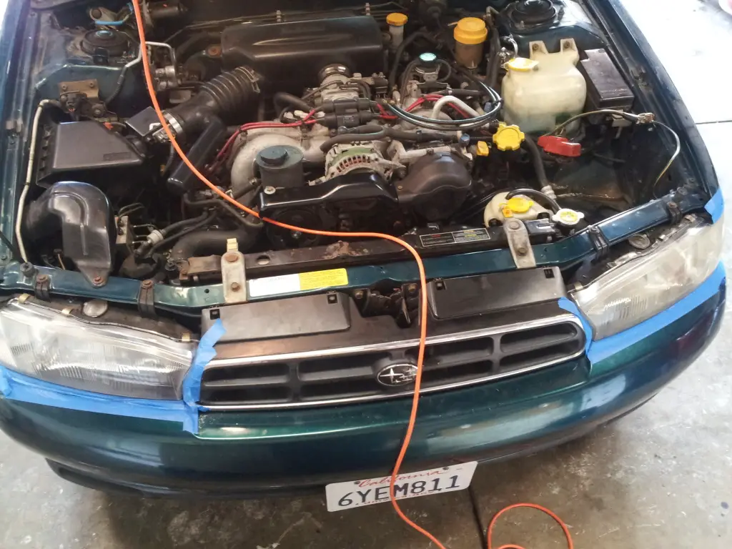

sorry it took so long, but here are a few pics of the results from using the 3M kit. the lens i used them on wasnt too bad to begin with, but these brought them back pretty good:
here's what they looked like before;
heres kind of a bad pic of one lens done
heres one of it finished. ill try to get an upfront pic of it tomorrow.
Looks good. Thanks for the update. ;):thumbsup:
