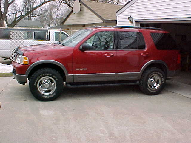

I've got 2nd gen wheels on my 04 xlt, the tires are 265 75 16.
they do give the x a wider stance.

My previous truck was a 2001 x sport... my current truck is an 2004 x xls, which has those ugly simplistic rims... I talked the dealer into swaping the tires and they worked great... looks improved a great deal... there is no rubbing... I did notice that the bottom of the calliper/break assambly looks to be really close to the inner part of the wheel/rim... I forgot to look in the original set of wheels so I don't know how close are they supposed to be in the 3rd gen's.
They stick out about an inch from the fender... I don't have any moldings or anything, which make a difference.
I have the same wheels on my 05 as rama1200. They are 16" with a +12 offset. My stock wheels were a +30 (I'm thinking). This moved the tires (245/75/16) out to the edge of the wheel wells. I think the 2 gen wheels on the 3rd gen is a perfect fit.
