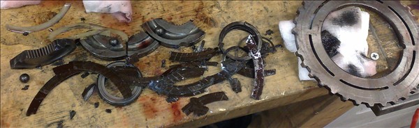

looks expensive :rolleyes:
where could i order parts?

today has arrived tbtrans package to me.
i have buyed spare parts to old t-case.
spare parts cost me about 300$ so i saved some money and service works just fine!!
tomorrow i have to start repairing and put parts together.
