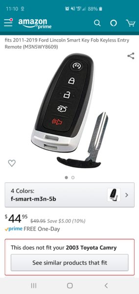

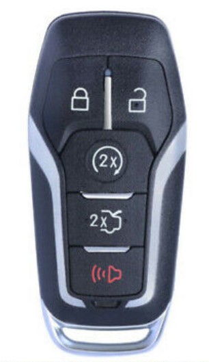

Here's my issue. I just bought a 2018 Explorer with a 5 button FOB or Intelligent Access Key as it's called in the manual. I only got one and need to get another one. Are the used ones just as good? Ford says no, but I'm sure they want me to buy a new $250 one. They say the used ones might work or might not. I'd hate to pay the programming fee then the FOB not work. I can get a refund on the FOB but of course not on the programming fee. Any advice would be greatly appreciated!
For my '18 Sport, I bought a used 5 button IA FOB off a '17 Fusion and since I had both original FOBs, I programmed it myself. The used FOB works perfectly. I just had to get a key blank off eBay and get that cut. As others have stated, without the 2 originals, programming would have to be done by a dealer or locksmith.
