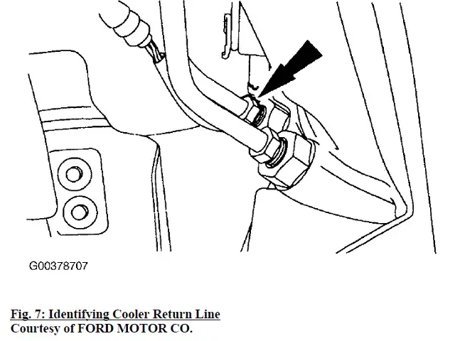

The photo below from my RatioTek manual shows the 5R55W external cooling loop ports.
The ATF cooler flow test in my 2003 Explorer shop manual identifies the direction of flow for each port.
The upper port is the 5R55S ATF inlet (return line) from the cooler and the lower port is the 5R55S ATF outlet (supply line) the to the cooler. I purchased an F350 Super Duty ATF cooler for my liquid to ATF cooler.

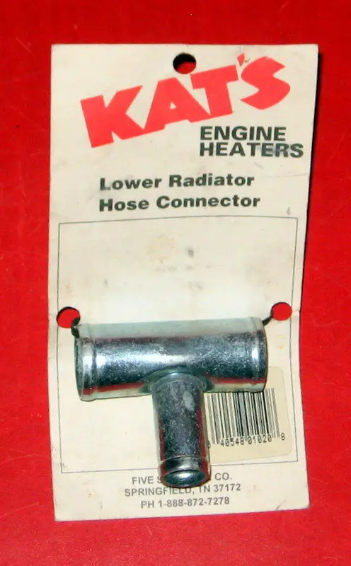

I plan to insert a 1 1/2 x 5/8 x 1 1/2 Tee (Kat's P/N 28115) into the main return line and connect the 5/8 port of the Tee to the ATF cooler coolant return port.
On the passenger side of the radiator the hose to the degas bottle is 1 inch diameter.
So I'll insert a 1 x 5/8 x 1 Tee (Kat's P/N 28113) with the 5/8 port being the coolant supply to the ATF cooler.

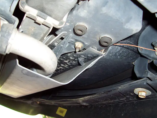

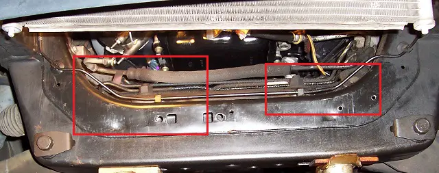

Below is a photo of the planned area for the transmission fluid cooler.
The ATF cooler lines will have to be relocated as will the power steering fluid cooler.

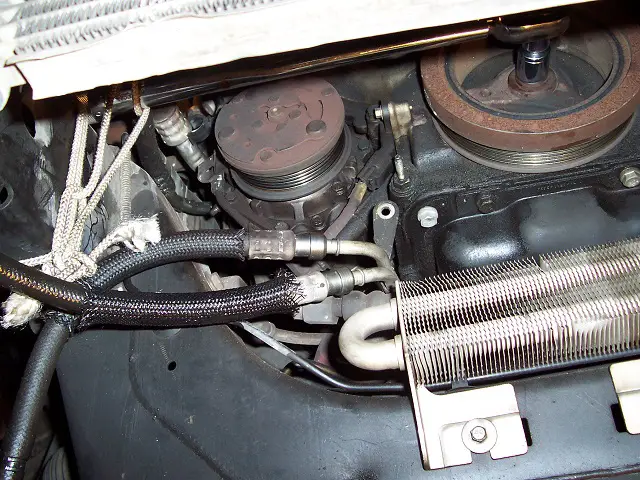

Below is a photo of the planned area for the power steering cooler with the oil filter splash shield removed.
The stock cooler takes a lot of space due to the long tube fittings. Also, the ports are on the wrong side if it is moved significantly toward the driver side. To make things fit I'll probably have to purchase a different configuration power steering cooler. The Derale 13310 shown below may be a good candidate.
It has -6 AN ports and built in mounts.
I removed the power steering fluid cooler and held the ATF cooler in position. It appears that there will be enough room for the ATF cooler and the Derale 13310 cooler so I ordered one.

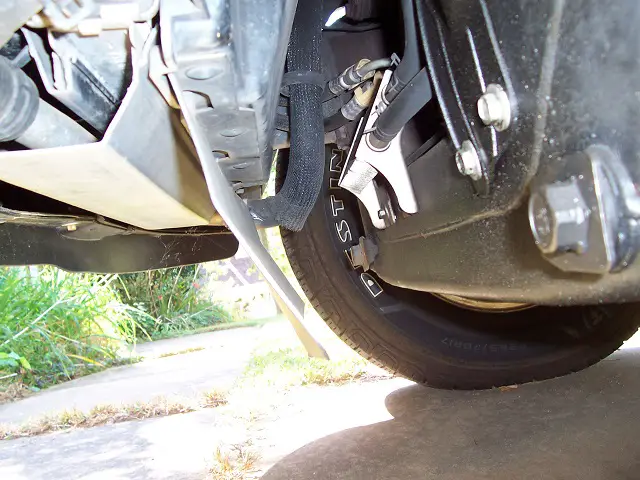

The photo below shows the passenger side plumbing for the ATF cooler. I inserted the 1x1x5/8 inch Tee and attached a 5/8 inch hose with a molded 90 degree elbow (Dayco 80404).
The lower left corner of the bottom photo below shows the coolant 90 degree brass elbow and hose with a molded 30 degree bend.

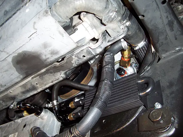

Initial plumbing of the ATF cooler is complete. The photo below shows the driver side plumbing after installation of the lower fan shroud. The lower radiator hose must be disconnected from the radiator for the shroud driver side mounting tab to clear the radiator port. I cut the lower radiator hose and inserted the 1.5 x1.5 x 5/8 inch Tee and attached a 5/8 inch hose with a molded 90 degree elbow (Dayco 80404).
The driver side is shown below.
The upper section of corrugation is to prevent hose abrasion from the power steering fluid cooler. The lower section of corrugation is to prevent the hose from flattening where it bends. When I finish installing the cooling mod upper radiator supply hoses I'll perform a leak check with my hand pump.
