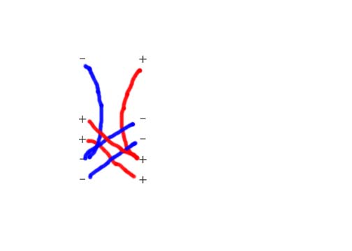

well i SHOULD get my sub back tommorow and apparently i havent had it hooked up right the last 2 times. soo my question is can someone show me how they have their wires hooked up to the sub. if i remember right it looked like this on the back if the sub is right side up.

yup my amp runs at 2 ohms stable and it is the 1200Q and its dual 4 ohm voice coils. the last 2 times i had it wired up so that only one coil would work. so can you show me how the wires should go?

that's one of the worst things you can do to a subwoofer.
both + terminals on the sub should go to the + terminal on the amp. and both - terminals on the sub should go to the - terminal on the amp. that is how you wire the coils in parallel.

alright im so out of it that i still dont understand it, this is how i had it wired the first to times.

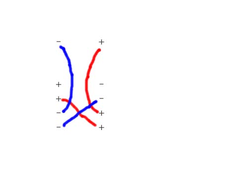

on the subwoofer, there will be two + and two -
connect one + to the other +. then connect one - to the other -.
then connect a + to the amp's + and a - to the amp's -.

actaully, your sub will be wired to 2 ohms mono.
