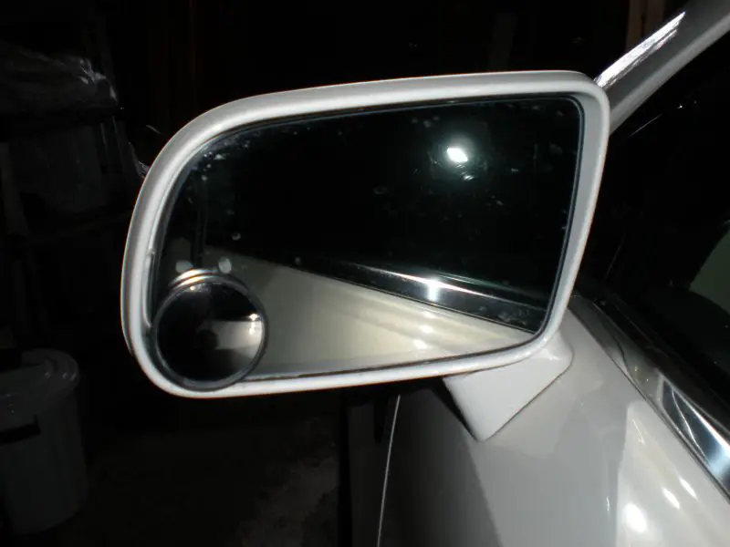

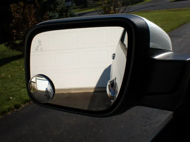

Is the glass on the Lincoln a different size than the one on the Ford?
Here are pics of the mirror from my 2011 Limited (top) and my current 2014 MKT. Not sure if the MKX is the same as the MKT.
Peter
