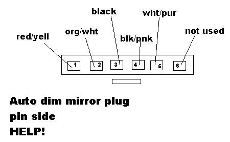

ok, i bought me an auto dimmer morror (rectanglur) from a 94 limited. anyway, ive searched and searched again, and have come to the conclusions that my wires are different colors than the ones listed on te site (in general posts) what i need is someone to look at their plug on their mirror (back side) and tell me what color wire is on which pin number on the plug. thanks a lot! below is MY plug with MY wire colors. I need the right ones so i can install this . thanks!

Well...according to my shop manual, the only wire that is different is your orange/white wire. All the pins are in their regular positions so I would guess that wire is still Power (hot at all times). But use a battery and try it out and make sure it is the correct one.
