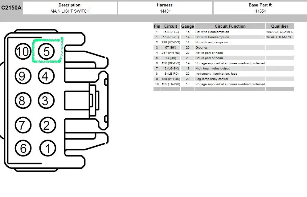

I took my headlight switch out and changed a couple of pins round to make the Spotlights come on with the headlights when on automatic.
Basically my switch was like this:
You just need to jump wires 2 and 9 to make the spolights come on with the headlights and turn off when the car is locked.
Ive noticed some of the switches are different in the wiring so if its not right you can just get a small length of wire and put one end in the light blue plug, turn the auto lights on and find the one that makes the spots come on. There is a few that will do it but only one that will make them turn off also otherwise they will just stay on.
