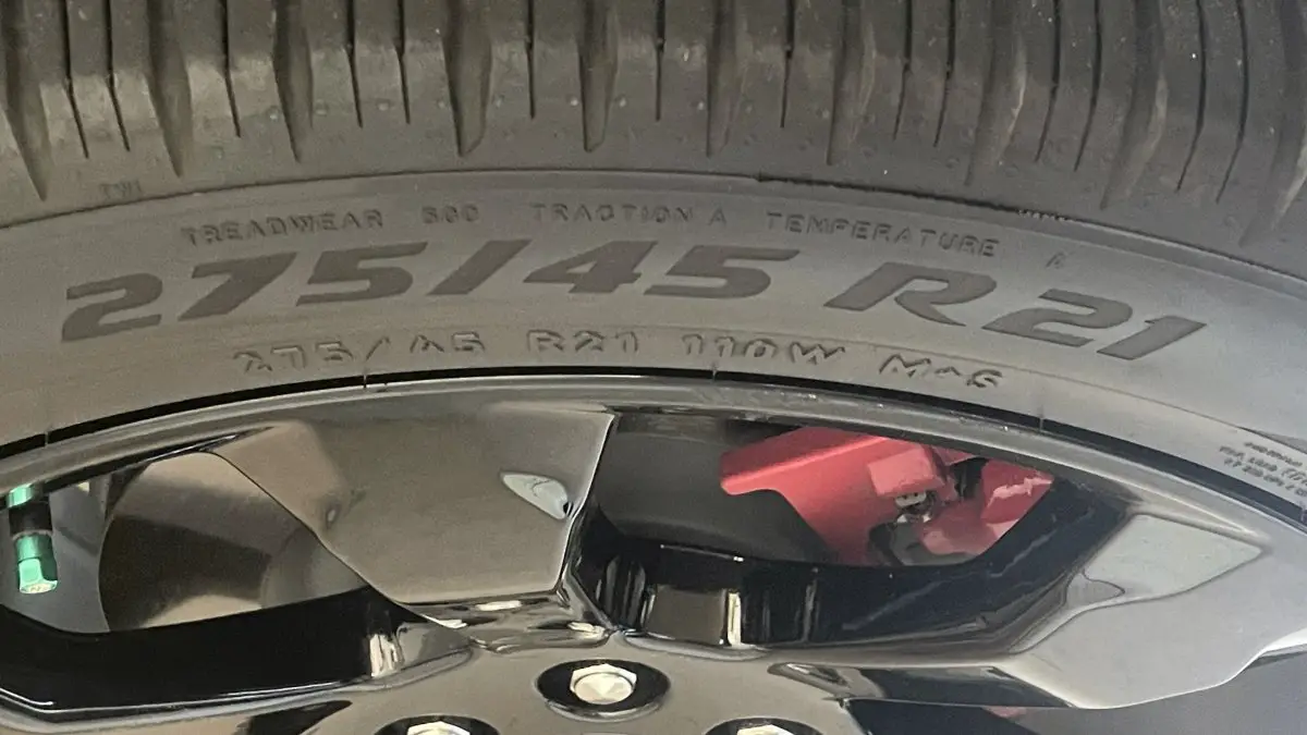

Hello forum, I have somewhat of a concern with a purchase that I am about to make at my Ford dealership. I want to buy a 2020 Explorer ST with the Street Pack which comes with 21" wheels and I noticed on the 150 Point Inpection sheet it shows the current tire tread depth which is 7/32 for the rear and 10/32 for the front. They are all 4 Pirelli Scorpion Zero 110V M+S 275/45 R21 tires and when I asked them why do the front have different depths then the rear their response was that the two in the front are new and the rear still have more than 50% left. So now my question is: can my Drivetrain System or Intelligent 4WD get damaged if I drive it like this ?
I know that the ST is now RWD Bias which only turns AWD when necessary but still, should I ask them to put two new ones in the rear ? I just do not want to have to spend $600+ on two Pirelli Scorpion Zero tires, asumming that they are even needed. What do you guys think ?
Here is a picture showing the front and rear tread:

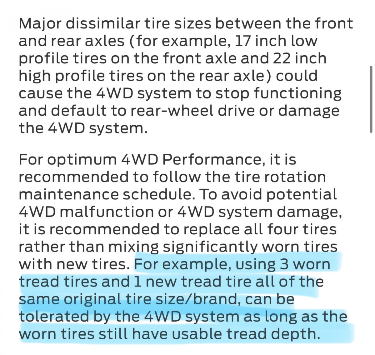

Thanks for your reply. I just found this on the Explorer ST Manual. Seems that I will be fine. I'll still ask them to put two more new ones if possible but since the old ones have more than 50% life left, I doubt they would do that.
I'd still do one of the options I mentioned. Whether it "can" compensate or not, either way something has to slip more, constantly, even in a straight line, than if they were all the same diameter. I take that back, if the same axle has the same size on both sides, it could disengage the driveshaft to that differential, but it's still the times it is engaging that I'd be concerned about.

From the pictures above, the rears look much more worn than what they're telling you. I would go buy a tire depth gauge (they are cheap) and check it yourself. I would bet they are not 7/32". More like 4-5/32". It could be the angle of the photo but the center of the tires look worn as if they were driven overinflated.

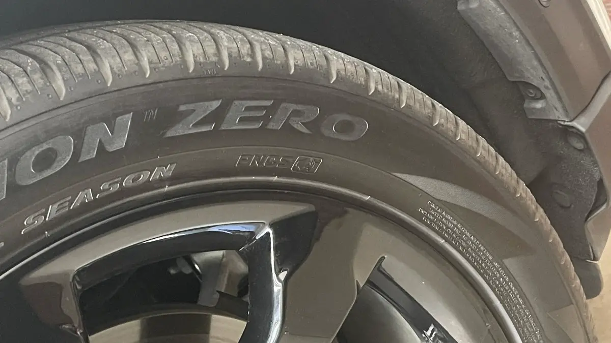

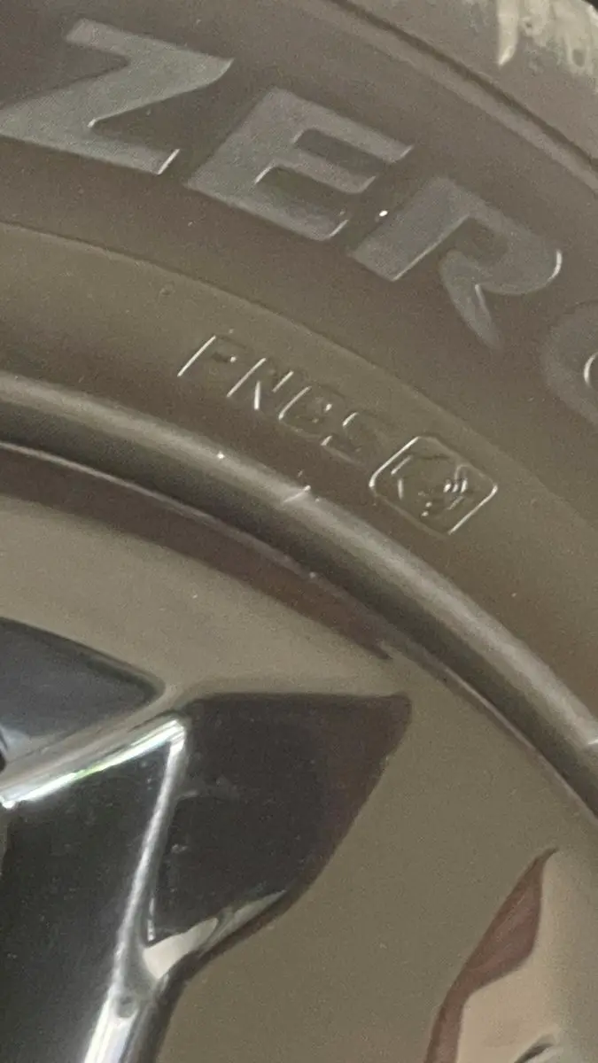

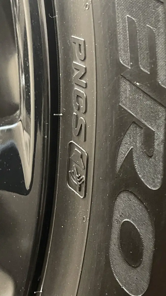

Are the tires marked PNCS? I had to replace all 4 at 25K due to vibration issues caused by loose foam inside the tires. Known problem in hot climates. Really bad to road speeds around 65-70 MPH.
They are not marked PNCS. I only see 275/45 R21 110W M+S A087224
They must have put two different type of tires on the Street Pack. Mine were marked "PNCS" under the "ZERO" marking. If not that is a good thing for you. Unless that had already been replaced.

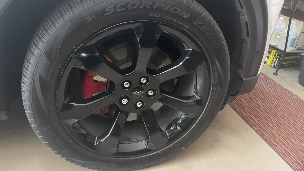

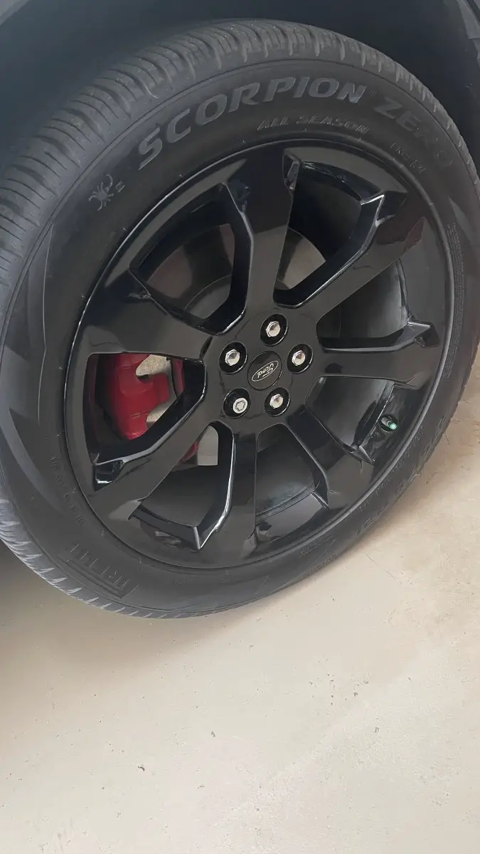

You were right, I went down there and measured them myself and the front has 10/32 and the rear has 4/32 - 5/32. But they do not want to change them because they say that it still has life left. I am thinking of just backing off from this deal and wait it off for now.
