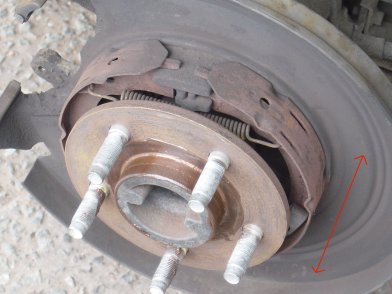

While finding out why I had zero hand/emergency/parking brake (see picture) we also came across a fair amount of play in the hub/drive shaft assembly. Can anyone tell me how much play is acceptable when pulling/pushing the hub assembly in the direction of the arrow?

Don't know but mine did have play. But no noticeable problems so I just ignored it. Both sides seemed similar

There is quite a bit. I don't have a number :(
I remember about 1-2 cm, If I remember right.
sounds like more than I had
Wait, not 2 cm. I'm way off on that. Don't ask me what I was thinking. Probably max 1 cm.
The axle will move in and out at least 1/8" or so.
Its normal for the axle shaft to move in and out a little. When you are moving the axle in and out you are taking up the play that is built in to the c-clips and the carrier. Its not something to worry about.
Did you have to replace the drums when you did the brakes? They look pretty hammered! :)
Thank you to every one who responded!
I would say that we found approx 1-2 mm of play which when compared to "normal" cars would cause concern but we just have very little to go on here. There are just too few Explorers locally (so few that we tend to wave and flash headlights furiously at each other as we pass - yes it's sad, I know). No one really has much knowledge of whats right or wrong. I have a Haynes and a Clinton manual and a Ford CDRom but they're not too much help. The CDRom mentions .762 mm play but you need to use a dial gage and a stand to measure this. Needless to say I don't have either. I'm not much into spending my hard earned cash at the local Ford dealers so I'm pretty much on my own.
