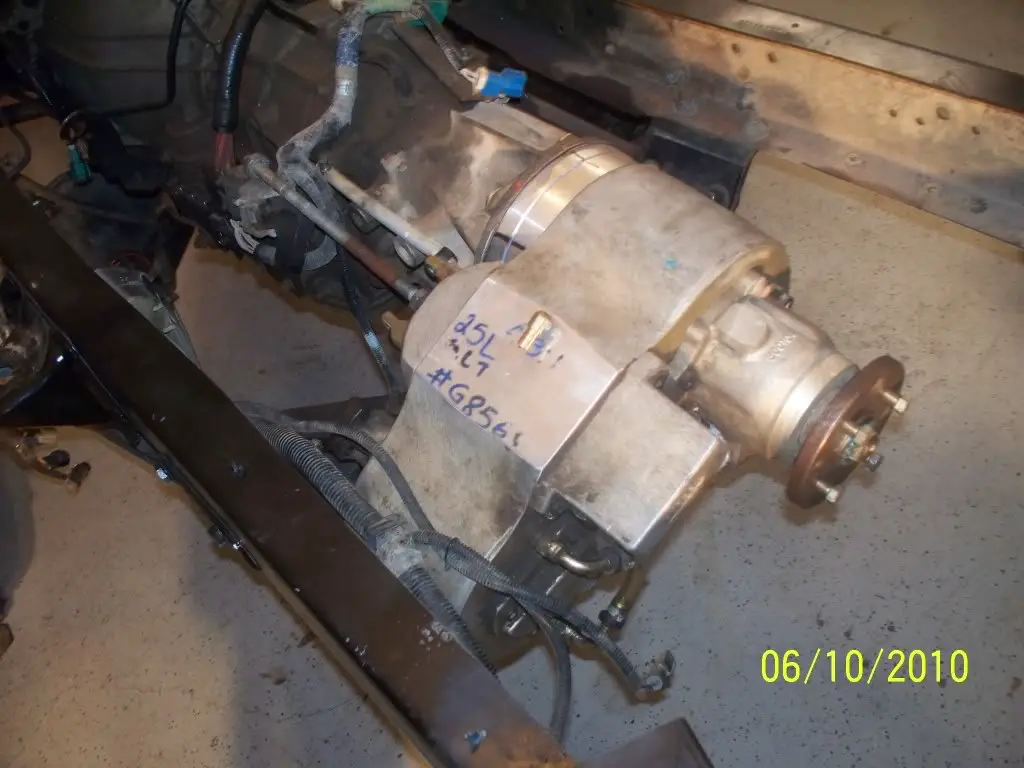

I was gonna say..."Was that an ATLAS?" What set up is it?

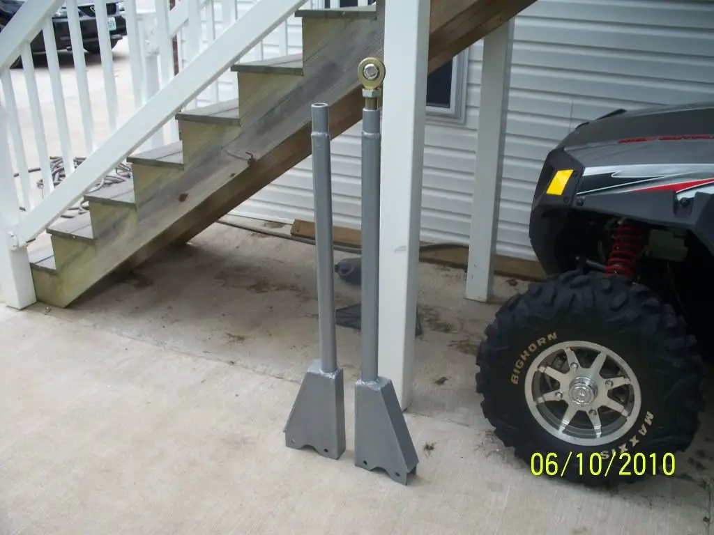

So a weird thing happened yesterday, got home and noticed on my porch another delivery from UPS a box the same as the one I allready got from discount steel where I order my DOM tubing from, kinda scratched my head cause I allready got my DOM tubing order. Pull the ticket off the side and sure enough got the same order I just previously did twice LOL, the DOM for longarms, steering and track bar, so I called around trying to make sure I wasnt charged twice, concluded i wasnt.
Called steel co. they realized there error and we made a deal :) sweet one I think, moral of the story i have more DOM, and 4link seems more and more like a good idea to start now on!!!

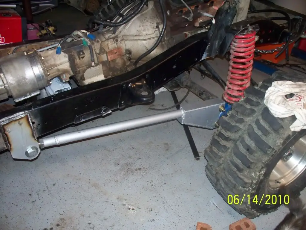

Been working hard on the beast last nite and today! Longarms are all mounted, i had 4degree wedge bushings, which may be to much, prolly only need 0, LOL, but maybe I will go 5.5 coils, which will make up the differance, cause right now i dont wanna pull it back apart.

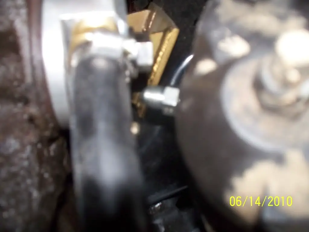

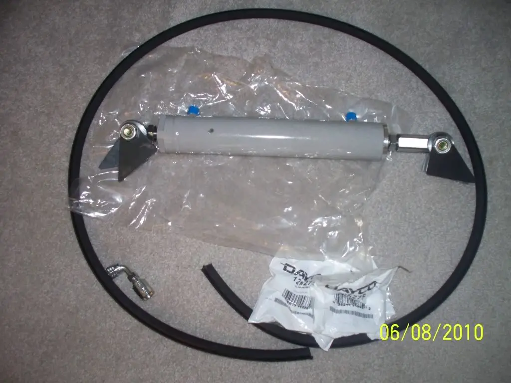

Install oil filter relocation L&L on the engine, getting ready to go back down and reinstall steering box, which is now tapped for hyrdo, went and flushed it out with parts washer for quite a while just incase in little shavings were still in it.

Port for hydro line need elbow to close to oil filter relocater

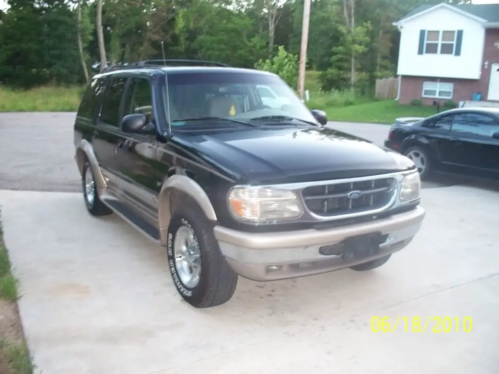

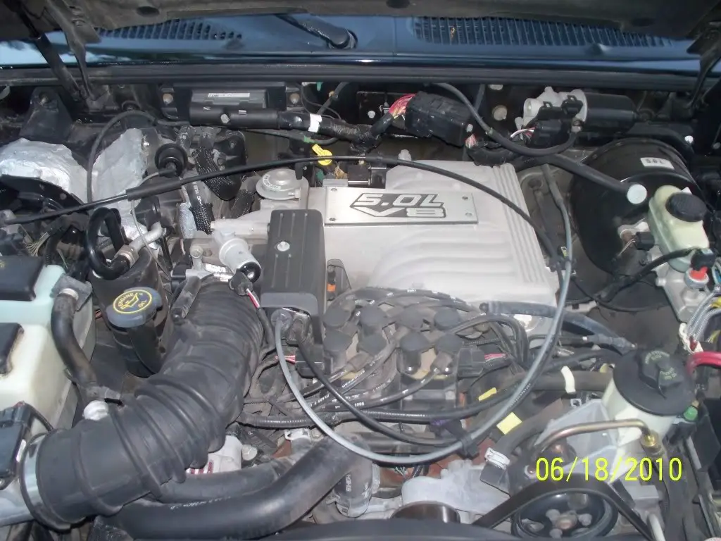

Starting to rip into the explorer:

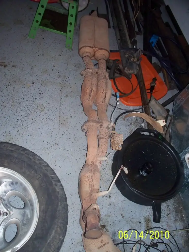

Complete exhaust, has newer flowmaster muffler, will all get modified
How much for the back bumper on the Ex?
Motor any good?
