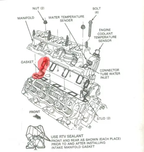

Leaks on the back of the engine could be the lower manifold seal (red area on pic) or the head gasket. The freeze plugs run along the side of the block. (I assume 4.0 OHV)

its not on the block and its not the gasket. its a little bit higher. anyone have a picture of a brake down of the head. i have an idea of where it is i just need to find out whats there. trust me i dont need to pressure test it. i hook up a garden hose to it and i get a pure stream. the only thing is, i want to fix it with out taking apart 1/2 of the top end. and it dosent seem to be a hose(from what i can feel anyways). i appreciate your guys help. i know this sorta stuff has been addressed before but i couldnt find anything like my problem. im probably gonna tear into it on monday.

thats what im hoping for, but like i said i cant feel a hose. if it was a crack i wouldnt even notice. it would trickle out. this has gotta be a hole cause it pours out. its raining now so i wont get to it today. but i will let you guys know what is causing this. if anyone has a pic of the pass side back of head, either a real photo or out of a book would be appreciated.
thanks for the pics, thats what it might be.
Usually it's the Intake manifold gasket but it is usually the Drivers side Rear or the Passenger side Front.
Still very likely the Seal where Shamaal redlined
