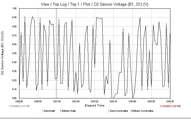

Would a faulty fuel pressure regulator cause those 02 readings? I don't know how to read those printouts, but quite impressive... I do know if the FPR is dumping gas, it'll affect you milage.
Reading this thread, and all that Buff has replaced and tested, I would have thought that a possibility too...but then Buffalo said he tested fuel pressure at the rail and it was ok. But that makes me wonder, what is the fuel pressure doing when he's driving around? On my OBD-I truck, I don't know of a way to test it while I'm driving, unless I went to the trouble of installing a fuel pressure gauge on the A-pillar or something like that.

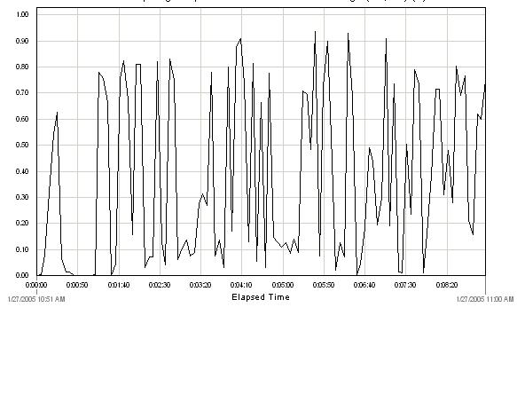

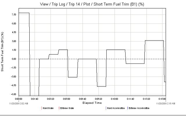

WOW...Some of ya'll are way out there...Thats why OBD Diags should be let to the trained people. If you had excessive fuel comsumption (high long term trims) you should set a code. Just as you should have set a code for the inactive cat converter. the downstream O2's are fluctuating too much. The highs and lows in the graph aren't intake and exhaust stroke, they are the computer switching the fuel mixture back and forth from lean to rich. Thats how it maintains a stoichiometric (sp) mixture.
I understand ya'll wanting to save money and all, but by the time he does all the tests and repairs you suggest, he could have had it diagnosed and repaired (also count fuel savings in this over this 4 or 5 month time frame), for less money and had a cleaner more effiecient runnung vehicle. As it ends up, he's still probably not fix'd, and it appears a re-flash is in general order. Which I am sure he will have to go have done unless he happens to have an NGS, a laptop, and the lastest flash software to do it...
