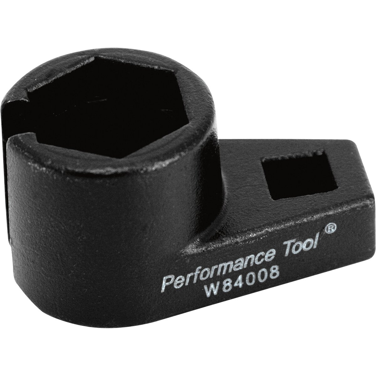

I've never used it on the Explorer so I have no idea if it would help but I have one of these that I've used on other vehicles.
