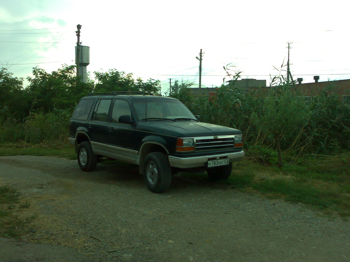

Looks pretty much just like this one:

The truck in the above picture looks a little bit lifted to me. That's not the one you bought, correct?
