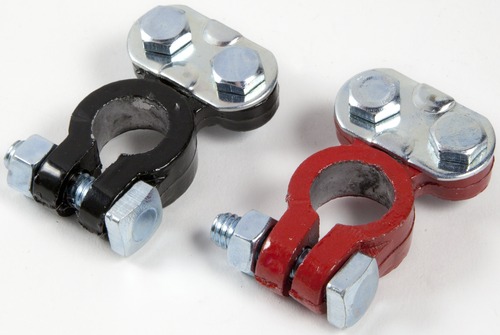

The first incident sounds like one I have had, and just recently had again. Turn the key, click, and everything is dead. My ex-Ford mechanic ex-neighbor replaced my failing battery terminals with a pair of terminals pictured below. Just a spare pair he had in his toolbox. Worked great for years. Out of nowhere, the one-click-dead issue starts. I cleaned off all the corrosion, sanded the battery post, sanded the inside of the battery terminal, and hooked it back up. Still one-click-dead. Finally figured out that the unseen corrosion between the wires, and where the terminal clamps to the wire, was the problem. I cut off and stripped the two positive wires, cleaned up the internal area of the battery terminal where the wires go, tightened them in, and problem solved.
Within the last couple weeks, the problem showed up again. I just wiggled the positive wires, and starts fine. The two terminal bolts were kinda loose, so I tightened them up. I recently just changed those red and black terminals to solid brass terminals, hoping no corrosion will return.
