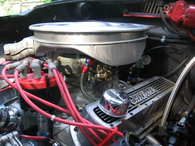

Don't be afraid to add more if you like. If you look in the pic I even ground one head to the other then to frame. You can see bolt connecting a high quality cable to the bottom of head.
...i wonder if this could fit in my ranger with minimal trimming...:scratch:...:thumbsup:
Wow! clean setup Rookie. I went ahead and bought a new battery and good cable (didnt skimp). I don't have a massive system, but don't want to destroy my components.
