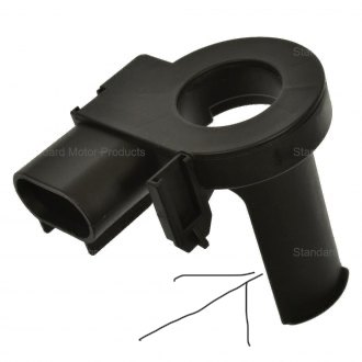

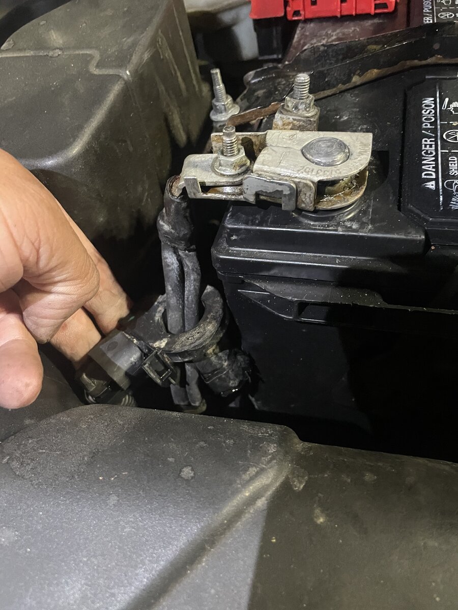

Anyone have any clear instructions on how the current battery sensor goes taped ? F4B94DEA-DC8A-4FFE-8097-E43A89086273.jpeg
Just affix (tape or zip tie) the "tails" to the negative cable assembly.
It's the ring that the cables pass through that is the actual sensor element. The mounting "tails" are there to keep the cables running through the axis of the sensor ring in a perpendicular orientation as needed.
So in theory should work without even being taped? Mine is making my lights flicker but when I wiggle it it works so I’m gonna replace
