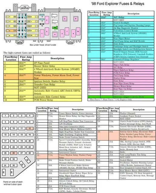

On my 98 SOHC 4L, fuse 25 is GEM, instrument cluster and securi-lock. Under hood box, there are both bigger fuses that go from 1 to 10 and little going from 1 to 15.
On the little ones 7 = ABS, 8 = Rear Wiper, 13 = O2 sensor/EGR regulator/EVR Solenoid/Camshaft Sensor/Canister Vent Solenoid.

Although mine reads securi-lock for the interior fuse 25, your might not have that since mine has the PATS2 security system that debuted in '98 AFAIK, but I'd imagine you probably have the GEM on that and it could be bad. You could unplug it to see if that stops (decreases total) current flow by as much as pulling the fuse does.

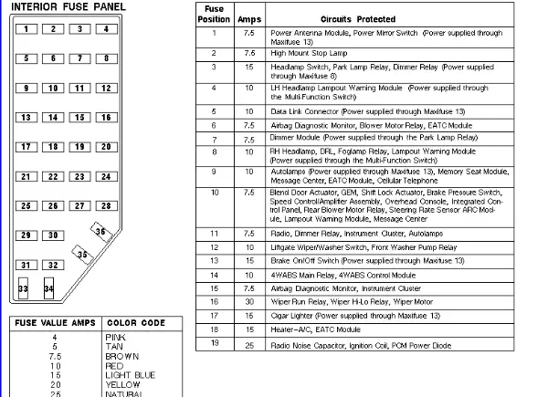

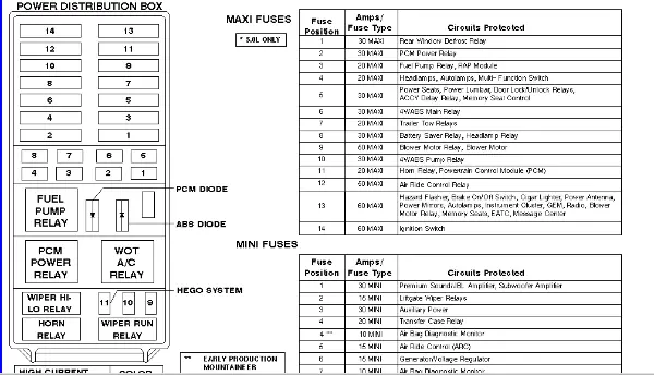

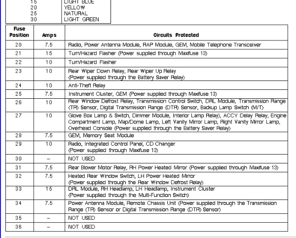

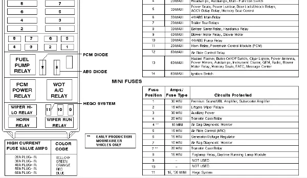

thank's for your reply... and found few pictures of fuse boxes for 1997 XLT V6 SOHC
yeah it looks like they different from yours....
I'm thinking just to buy the GEM module and see how it goes, I read few threads mentioned about replacing GEM module... Hope it helps !
