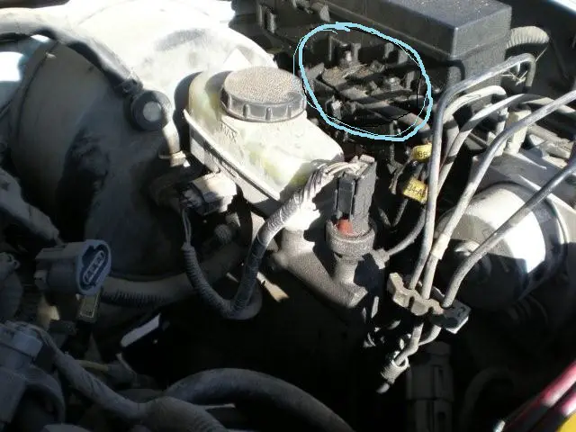

Check the megafuse..
It is mounted on the outside of the power distribution box on the drivers side under the hood...It should be a 175 A unit that is mounted between two terminals...I circled it on my power distro box...

Yeah I never knew about that. I will look at it later. Is it hidden under something like I have to take apart something because from looking at your pic I wouldn't know where to start to take it apart
