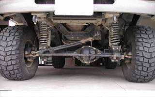

Here's the old linkange, F-150 style linkage that I bent off roading.

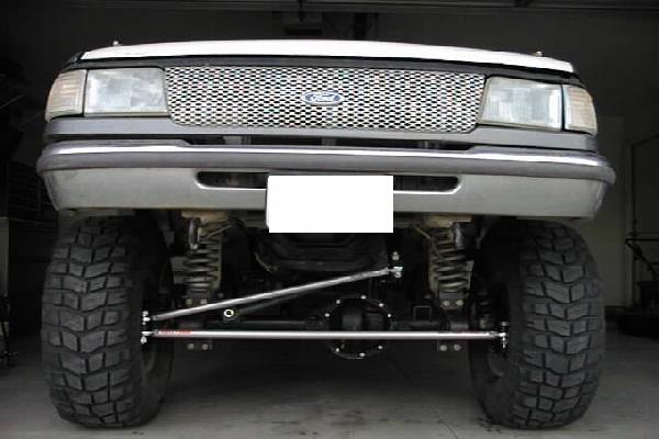

New Performance Unlimited drag link and tie-rod installed.
I went with the trail proof tubing on the drag link and Race proof tubing on the tie-rod and went with the stage 2(cro-moly) rod end upgrade.
I also got the tie-rod-over-knuckle kit which i'll do when I
make a higher mount for the track bar, otherwise i'll have nasty bump steer.

You got misalignment spacers on the drag link? Doesn't look like it. I'd think you'll need them with the straight link once you start flexing.
And if you do, how'd you manage bolting both links to the knuckle (with only one heim using a spacer)?
The rod end on the knuckle side of the drag link is sitting on a spacer, on the bottom side of that is the rod end of the tie rod sitting flush against the knuckle.
The pitman end of the drag link is a larger spacer with a flared head where the bolt is, rod end, spacer then pitman arm.
They say not to use a spacer between the tie rod and the knuckles unless absolutely necessary. I'll keep my eye on the rod ends and look for any contact. I cycled the steering and so far it looked good.

I don't have spacers on my tie-rod. They should never be necessary.
I do have spacers on both ends of my drag link, and even then I'm near maxing out the heims at full flex.
My spacers take a 1/2" bolt vs. the 3/4" bolt w/o a spacer.
Right now the drag link and tie rod attach to different points on my knuckle, but I want them to use the same point, since as is, the steering box maxes out before the axle. Trying to figure out a 'right way' (ie no questionably safe ghetto fabing) to put it all together with one bolt.

Yeah Jefe, i forgot what your steering set up was like exactly. So you have the drag link and tie rod bolted into seperate holes? Also, did you have to have a custom length drag link made or did it bolt up in stock form?
Its all custom chromoly tube, just like yours is now.
Yeah, for whatever reason my pass knuckle has a place for two TREs, so I used one for the tie-rod, and the other for the drag link.

Jefe, how are the on road manners with your set up?
Mine feels tighter and a whole lot smoother but with a bit of bump steer because the drag link and track bar are a bit out of line but nothing too bad.
