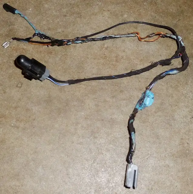

The fuse is installed there to protect the cable from catching fire when it is a short-circuit on that circuit.
Sure, it seems annoying that the fuses "blow", but it is better than an engine bay fire started by harness insulation melting and catching fire.
See below just a small portion of what happened to me because a Chinese fuse didn't blow correctly (the store recalled latter the fuse set):
