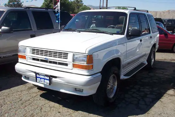

Try to post a pic. If your steering wheel and column is the same color as the rest of the interior then yours is a limited. These were the only ones built this way. Yes the limited also had the overhead console. Also is it white, green or purple? Those were the only available factory colors. If any of these colors, then is should have color matched front and rear bumpers. What wheels are on it? They had their own wheels as well. The interior was much different than other Explorers. The seats will be grey or tan leather with Limited stitched into them and have seperate headrests. The carpeting will be green or burgandy only and the tops of the door panels will be a plush type leather instead of the plastic panels.
I think to help you more accuratly, we need to see how your truck is constructed. The limited had its own wiring harness, unique to itself.
Here's one, like the one I have:
It doesn't sound like the limited. It has a gray cloth interior, no leather and no the steering wheel and column are not the same color, they are just black, and no overhead console. It has the chrome front and rear bumpers, no colors. Carpet is gray like the rest of the interior. I'll see if I can get a pic n here, tried to put one as the avatar but that didn't work. I would think it is just the XLT from the ones I've seen. I see the only way to get an image in here is to have the url and I don't know what that would be from my pictures. Why can't I get it in to be the avatar? I'll see if this will work. It has the spoked looks like stock wheels.
