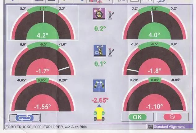

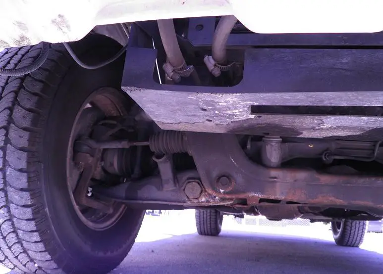

Im not a Ford guy but came into a very clean 2000 Explorer for next to nothing with lots of issues, (most of them I have corrected with the help of this web site) but I saved the best for last.
The previous owner Uncle Jack smashed the car into a high curb and bent the part that surrounds the A-Arm where the torsion bar inserts back about .800 relative to the same position on the driver’s side. A far as I can see the torsion bar did not suffer any ill effects.
The alignment people won’t touch it. Funny thing it does not drive near as bad as you would think by looking at the pictures. Pulls a little to the right but really not much worse than a Crown Vic in perfect working order, I am takeing it to a frame shop but I was interested in any thoughts the Explorer folks on this site might have regarding how to deal with something like this.

Have the lower control arm replaced have the front end realignment done
I would have expected the caster to be way off but it's not,the camber and toe should be fixable.But yea,have the A arm replaced and go from there.They don't want to touch it because of liability issues.:D

I might post more pics as the Sub-frame is also bent back about .250, however there does not appear to be any thing wrong with the part of the mount where the aft part of the A-Arm attaches. The damage seems localized to the forward part of the A-Arm and the part of the Sub-frame that it is connected to.
so now Im figuring the best way to bend it back?? Ideas anyone?

1995-2001 similar builds. All same generation. As far as correcting the bends via the curb i would suggest a body shop. They have a rack system where they can put your Ex on and with a BFH can straighten it out. You might was to have a look at your torsion bars. One seems like it's pushed forward more. I am no mechanic but i have spent days on end under neath my EX (You can always find something to tinker with). I agree with others, lower control arm first off. Take stock measurements from the frame and compare them. You will see a pattern of odd measurements. From that you can further more eliminate extra not needed things.
your caster is good i would just replace the a arm my caster is a little more off then that
