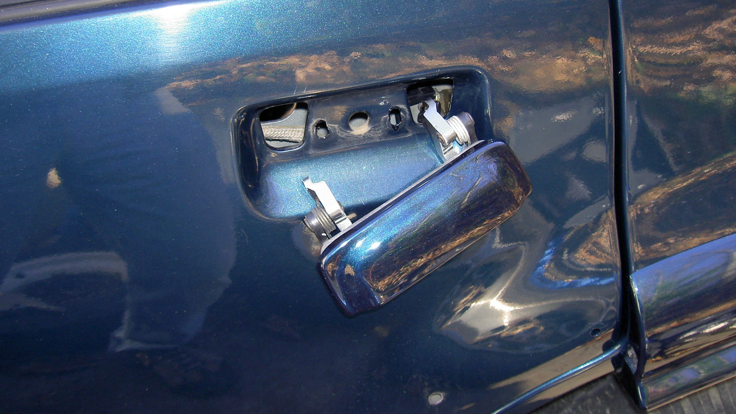

I do recall the 1st gen mounting holes are hair higher up on the doors. I had to slightly move/elongate the holes downward a little, see the picture below(touch up paint around the two holes there).
They all use two tiny springs, and when one breaks, then the handle starts to flop. When both break, then you're mad at it every time you grab the handle.
Here's a 1999 door handle after I painted it, going into my older 1993 LR door. See the minor handle shape change Ford made for the 98-01 2nd gen's.
