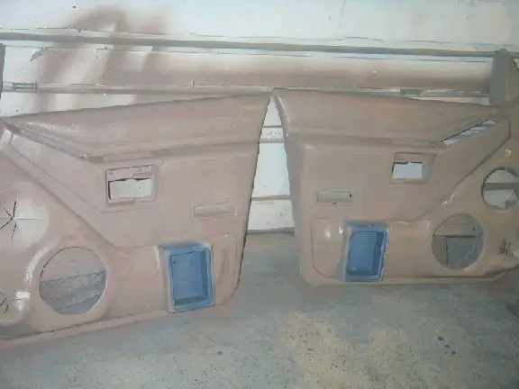

Well, to seal the doors I'm using a spray sound dampning material. The pods Ii am making are made of fiberglass. I still have some trim work to do, will be painting the x-over displays and fitting them with light and plexi-glass. Finally, I have some custom grills I'm making too. Here's a photo of my progress:

:thumbsup: looks good but did you paint the arm pad to or am i mistaken? that would leave a great paint rub on your shirt on a good day! otherwise i like the color i need to go ahead and do my doors like that there getting pretty bad lets see the custom grills
Oh, and the color is stock. I got the paint code so everything matches up. I will be re-painting all the plastic interior pieces as I move front to back with the stereo install
dayum i couldnt even see it! still dont i never am that complete thats why i dont do paint! by the way wanna do mine? :D
