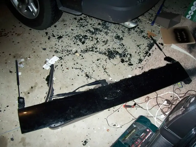

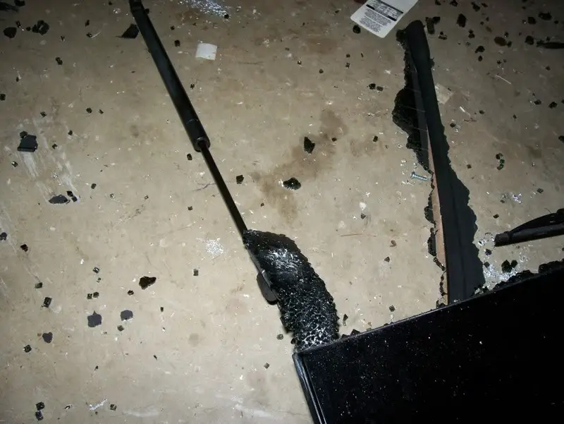

Ya i was in the middle of fixing my hinges and gave it a try lifted the top portion of the glass and it started to fall tried pushing it back up and BAM shattered all over me its literally all gone. Any have to replace is before? And how much would this cost to fix?
Now the glass is attached to this piece would I have to end up getting this piece replaced to?

ya its an 04 explorer but i had to take off the piece the glass was attached to and it seems that w ill have to be replaced as well

That happened to my '03 as well. When you get it fixed, you'll most likely need a new interior trim cover for the rear hatch if it bugs you- mine got all scored and cut up by the glass and looked terrible, I made the dealer replace that, and the trim cover that is at the back of the cargo area, by the door sill.
That eternal piece will most likely be all scraped up as well. They did replace that piece on mine, but I don't know if it had to, or if it was cheaper for them to replace and repaint it, than recondition and fix mine...

950.00 for that piece of glass. Comes with attached lower piece, there's a name for it, but I forget. Usually primered, forcing it to be painted at extra expense. Can't reuse the Ford badge ($56.00). Can reuse the windshield wiper and motor and arm, and rear cover bucket.
On the plus side, it came with hinges, which is what started it. One side was ****ed, causing it to be stressed at one point through its' range of travel. OH - good luck cleaning up all the pebbles. I still find them from time to time.
