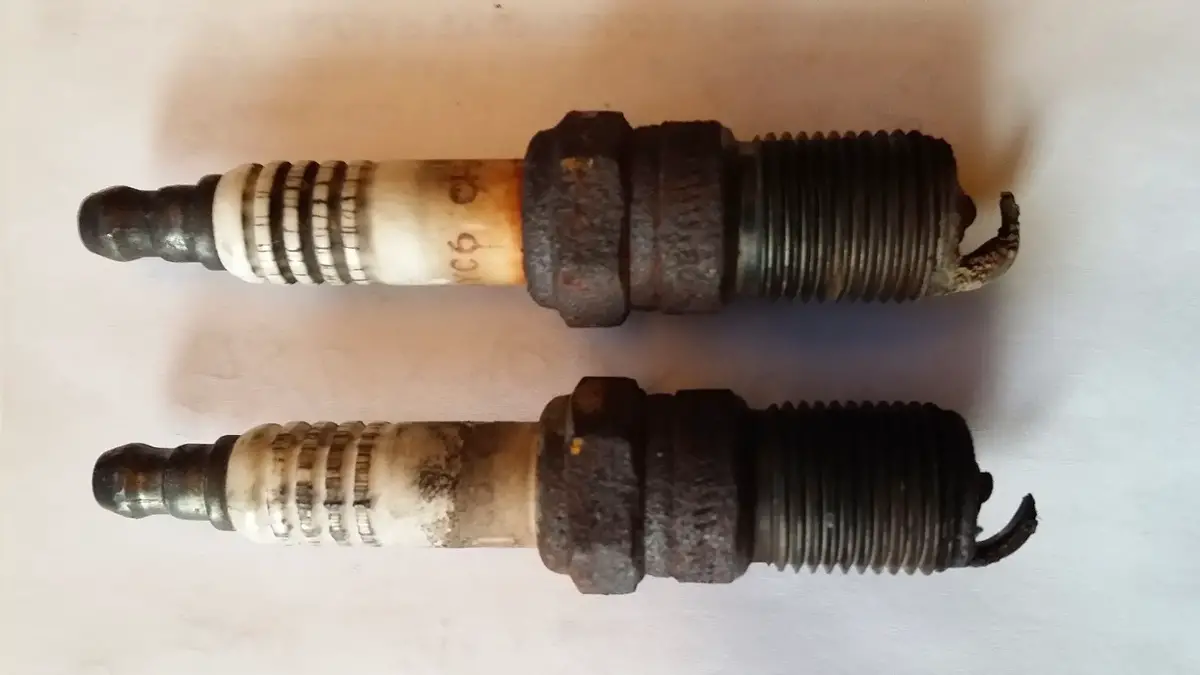

I still had the factory spark plugs and wires in it!
So, it being 15 years old with 274,000 miles on it, I was not about to tackle that nightmare, I took it to Pep Boys for them to deal with it. They did a fine job getting the old plugs out.

With those spark plugs like that...holy crap...you gotta wonder if anything else was replaced. That Explorer needs some serious love.
