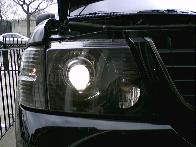

This is exactly what I was thinking about doing with my headlights; except I was considering using the regular silver headlights and not the black ones. Everything came to a screetching halt when I was told that this mod will cause mist to get thru inside the housing; especially with the kind of heat & humidity we have in FL.....that yeah that and the cost of course!!
Did u have any weather related experience or have you heard about such issues with people installing projectors on the stock housing?
I'm curious to find out.
Thanks.
you have to make sure you seal the lights really good...i use the NISSAN BUTYL (think thats how its spelled) headlight sealer that i got from a nissan dealership online and on the back i sealed up the opening around the projector with high heat silicone i got from the auto store...
