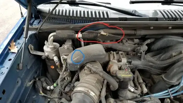

The link below is to the part I am referencing. It is located on the passenger side near the firewall an should be in a location where it can be seen. Make sure to note how the old part is installed and do the same for the new part. Here is a photo showing the general location of the valve. The location of yours might be slightly different.
Thanks Eddie again for your quick reply. I purchased the valve and I was about to install it but when I checked the photo that you sent, I found that the hose from the left side (where you have red circle) that supposed to go into the inside of the car or to a connector before entering the car was broken and now I'm trying to find how to replace that or if it repairable then I will repair it

I have found a broken vacuum line and tried to fix it. I reattached the hose again but barely attached then I taped it with wire tape but still did not work. i will try to reset. then I will try the control valve. The actuator looks fine from inside
