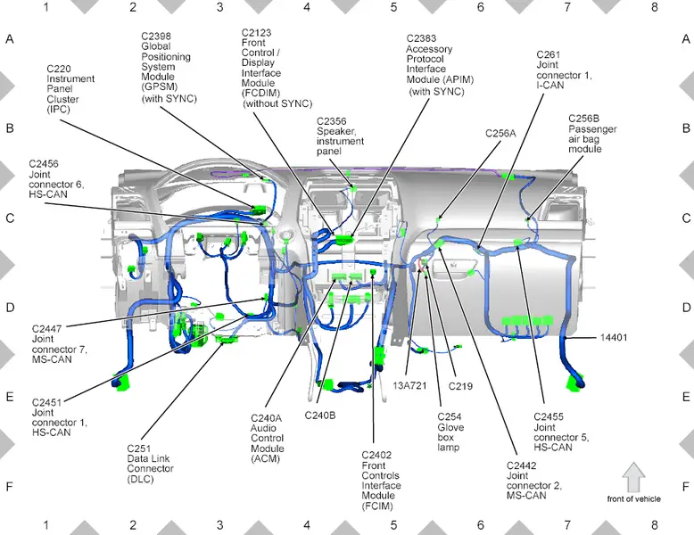

Ok so if I'm understanding you correctly, the APIM and ACM are two different parts. Where is the ACM located?
Yes, 2 separate parts. The APIM, Accessory Protocol Interface Module is essentially the 'brains' of MFT. The diagram below was taken from the thread 2011 - 2015 Component Location Views in the List of Useful Threads in the 'Sticky' section of the "Discussion" subforum.
