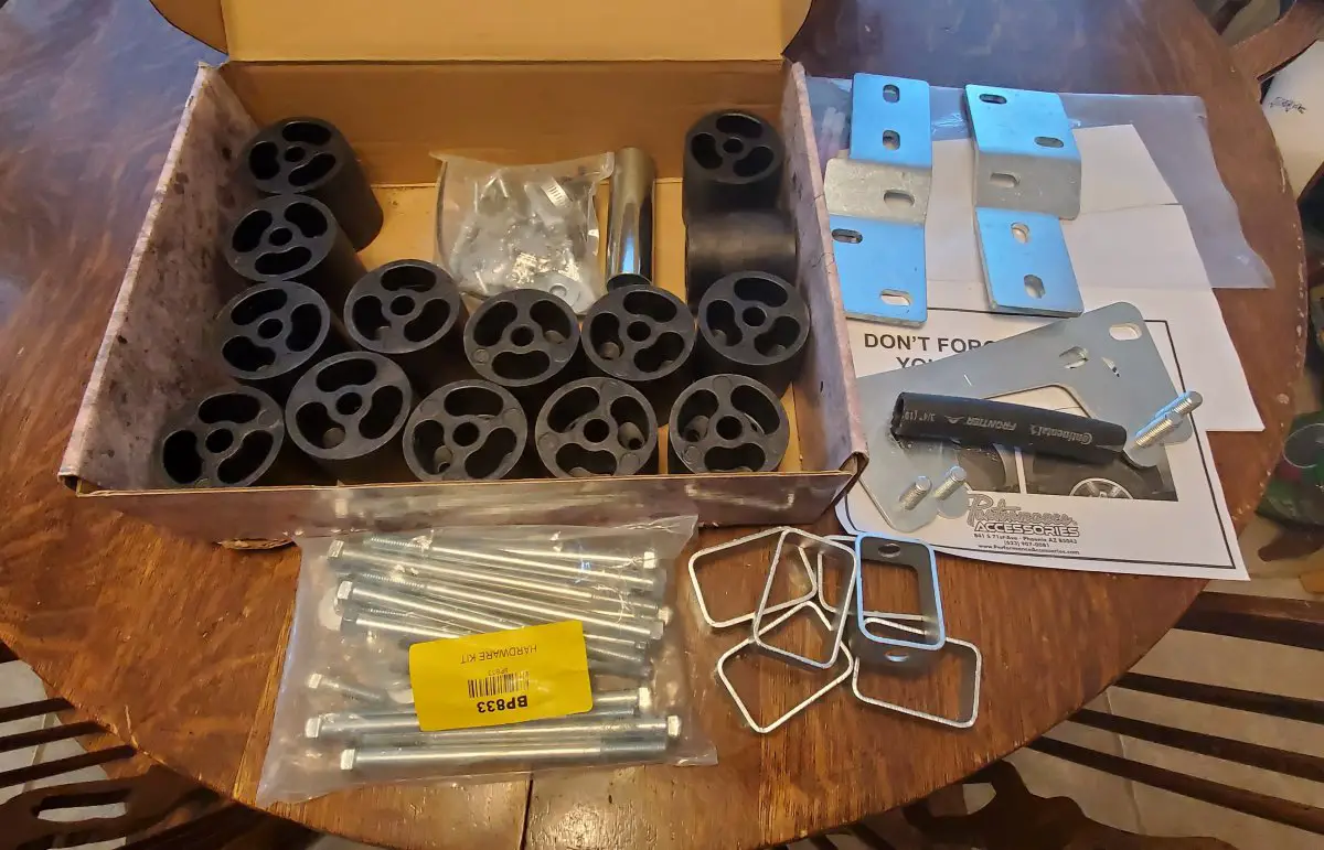

Also, it came with a new in the box Performance Accessories 3" lift kit and am wondering where are all the lift points located and can someone that has never before installed a BL kit be in over their heads. It has 14 spacers included. I suppose the first thing to do is take the seats out and the trim around the carpet in order to get at the body to frame bolts.

Thanks, the kit did come with bumper brackets and a bunch of very long bolts for the spacers. And 2 bags of nuts and clamps and some other stuff. It does seem to be very complete. I have no clue what those square brackets are or the round metal tube with the 6" hose. Lol
