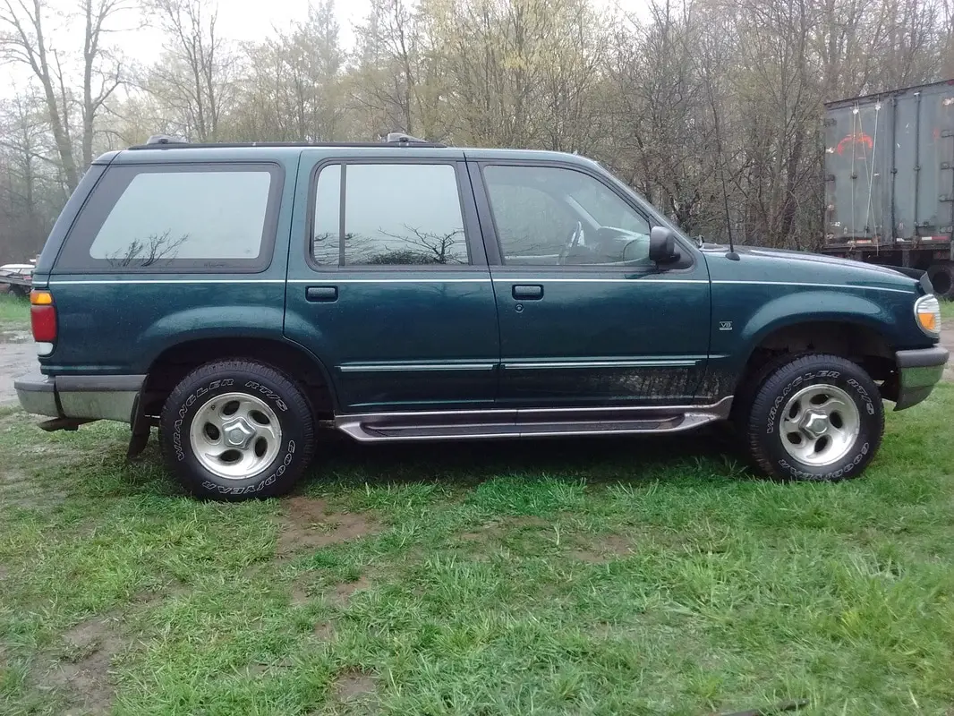

1 owner, has all service records from 2007-2015.
Grey leather interior, no rips.. Interior is actually in very good shape, cartridge for the multidisc cd player in the console is missing, the remote control is still in the truck though. The underside of the truck is a bit rusty but the body is still in quite good shape, no holes..running boards will still hang on for quite awhile it seems :)
Sway bar links seem ok and looks to have greaseable ball joints. Blower for the heat seems a bit weak and the resister for the modes of heat only works on high, as per usual with these things. The check engine is on, and I didn't get a chance to get the scanner on it yet. The engine doesn't look all dirty and leaky top and bottom. A/C doesn't work. Muffler has a leak as I see it's true duals back to the muffler similar to the SOHC.
270 000km so about 168 750 miles on the odometer. Puddle lights on the inside of the doors work, mirrors don't have them built in. I see the v8 has some sort of traction bars on the rear axle. Fog lights work. Small chip in windshield on the passenger side. Front driveshaft is still in it and I've tested it on some greasy mud, the AWD is working fine it seems. Beefy trailer hitch with the round trailer light plug, w/brake controller under dash. Has the Explorer floor mats and the cargo cover, also a nice form fitted protector thing for the cargo area in the back. Pinion seals on the front/back diffs seem to be not leaking. Rear axle has a leaking seal at the pass/ wheel.
